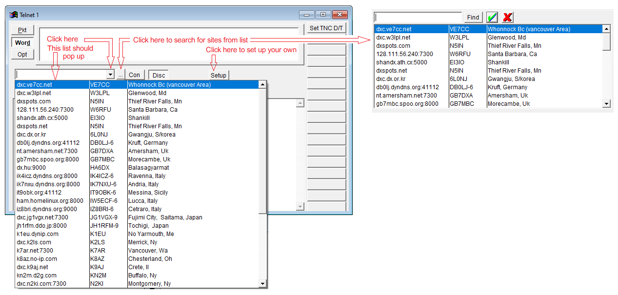

To add to what Kyle was saying I attached a pic of a Telnet window, maybe it will help. Not sure why you're not seeing the host list but you can add whatever you want by clicking on the SETUP icon in the Telent window....more visuals in the pic.

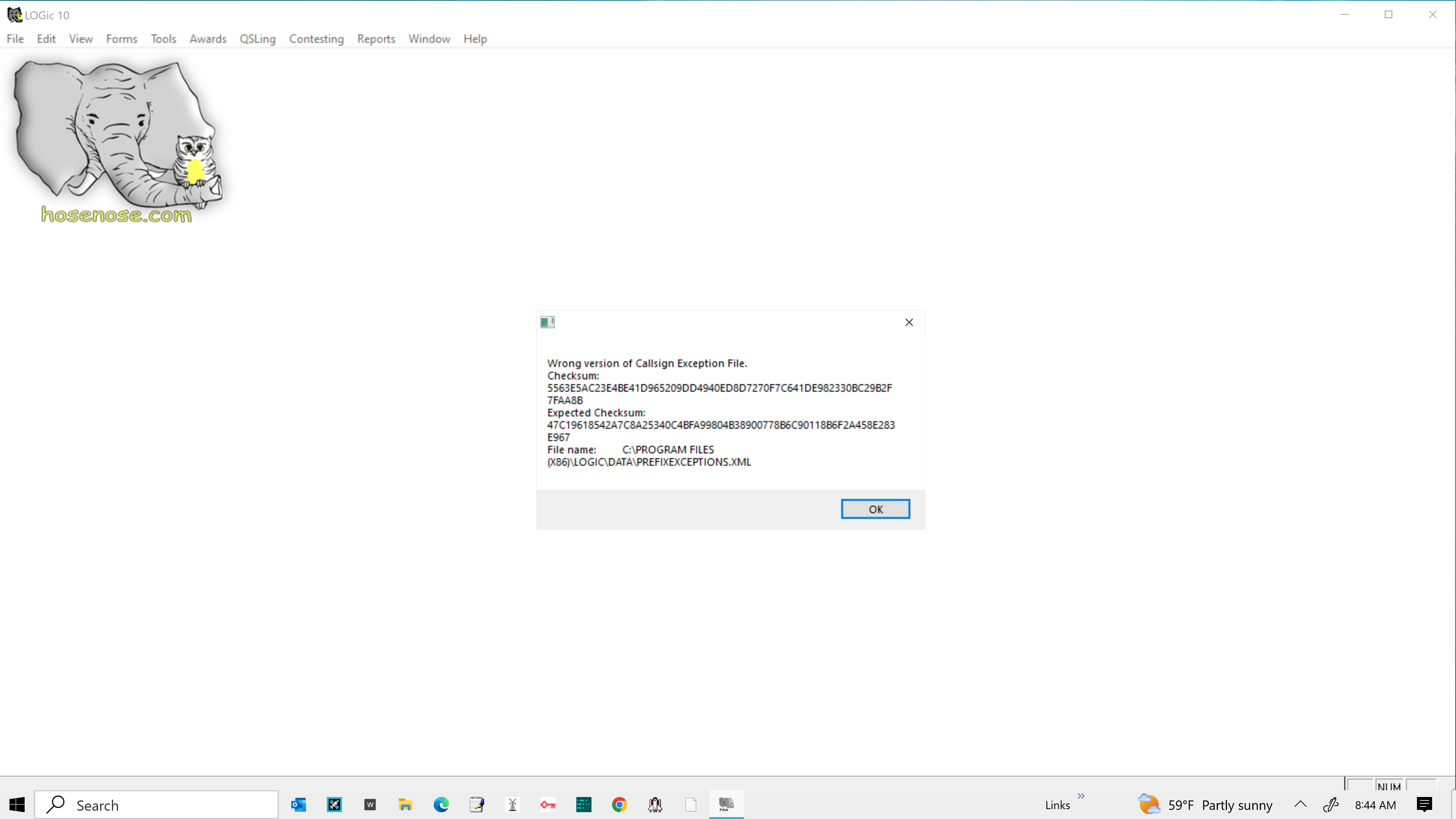

Yippee, Making some progress. I reloaded the program and am now able to enter a telnet host but the process still does not seem right. I still don't have a dropdown list that I can choose a host from. If a current list is available that I could load I sure think that would make things easier. I do make a screenshot of an error msg that I get every time I start the program and I am trying to figure out how to it to you.

Dennis will have to look at the error message.
If you click "Setup", another window should pop-up with host, no?
I attached a screenshot of the drop down from the Telnet form
2025-06-26 13_05_49-LOGic 10.png (10kb) downloaded 151 time(s).

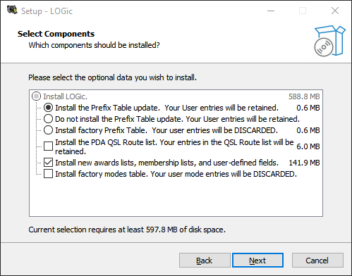

Re Kyle....if you click on SETUP you should see a list of 15 or so host sites, if still no list then somethings not installing or corrupt. The error your getting seems to suggest a problem with the prefix exceptions, I would try another re-install and when the "Select Components" window pops up select "Install the Prefix Table update..." and "Install new awards lists, membership lists, and user defined fields". If you did that then I would wait for Dennis to chime in or give him a ring. I attached a screen shot of the "Select Components" pop up you get when installing with those components selected.
