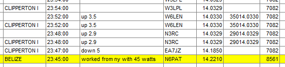

While listening for the DX Operation on Clipperton Is today - the calculation for TX Freq for the spot results in a corrupted frequency. If one attempts to "Set Rig" to the spot, an error dialogue results - as one would expect.
Clicking Ignore allows Logic to continue. The rig RX freq was set correctly.
I am using Logic 9.0.53.
Bad TX Freq from spot comment
Click Ignore  - continues successfully

.. I wonder what happend to the image I put in the post. Here it is again ..
Bad calc
It is a snap of the spot log - "as it happened", so to speak.
But, you are correct. I tried the test spot, and that functioned correctly. I tried 3.5, and 3,5 both seem to now function.
Clearly there is some other side affect at work here.
I do not remember if I tried the test spot last time. I think I might has simply accepted what was in front of my eyes - the image above of the spot log.

Ok, it is treating the "2.9" as an actual frequency in mhz. But where is it getting the "014.0329 part from"?
