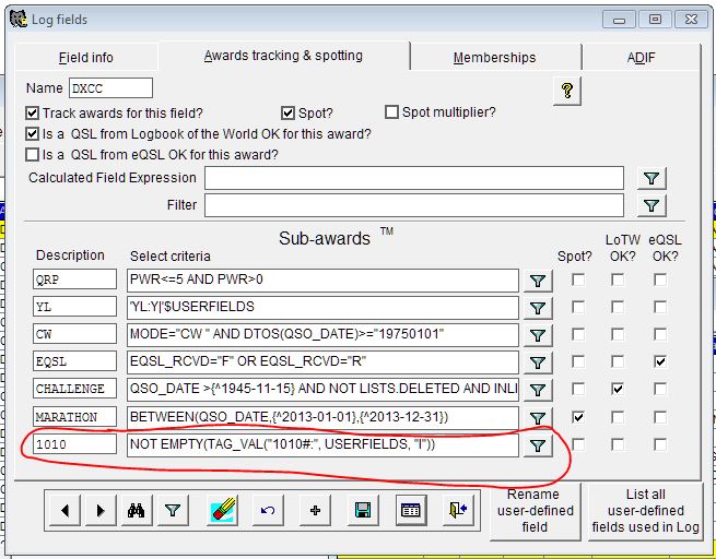

Set up a subaward as shown:
(Note that I just clicked the Filter button and filled out the form -- checkmark NOT then select EMPTY from the dropdown).
Update awards progress info under the AWARDS menu.
You can use online tracking. To print a report, use the usual old AWARDS report. For the OPTIONAL COLUMN, select 1010# if you want.
You don't need to create a new field for submitted status. Just enter DXCC1010SUB: or whatever you want in the comment field. Just like you do DXCCSUB: now.
