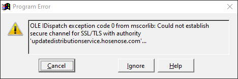

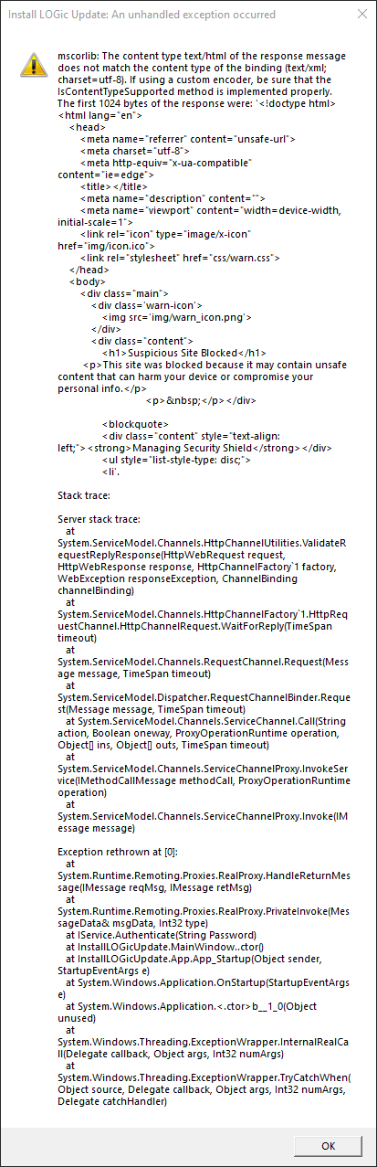

Must be something else, here's what LOGics Updater is returning...
PS: Also did the update to the updater client and get the same error.
From LOGic Updater.png (93kb) downloaded 10 time(s).

PS: Just Reinstalled LOGic just to be sure, same error. If running an update from within LOGic I get "OLE!Dispatch exception code 0 from mscorlib: Could not establish secure channel for SSL/TLS with authority 'updatedistributionservice.hosenose.com'..." (attached) along with the previous error.

The attached pic "ProgramError" is what I get when trying to check for updates from within LOGic (Help/Check for updates) followed by the pic "LOGic Updater-UnhandledException". The Program Error says it could not establish a secure channel for SSL/TSL, the UnHandled Exception says site blocked because it may contain unsafe content. I posted these pics before but again here. If I run the updater from LOGics program folder I dont get the "ProgramError" but it does throw the "UnhandledException".
LOGic Updater-UnhandledException.png (93kb) downloaded 2 time(s).
