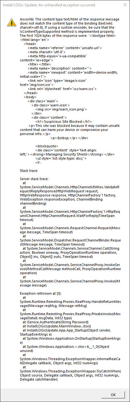

Must be something else, here's what LOGics Updater is returning...
PS: Also did the update to the updater client and get the same error.
From LOGic Updater.png (93kb) downloaded 166 time(s).

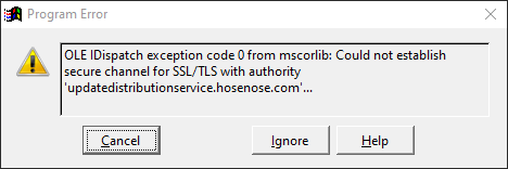

PS: Just Reinstalled LOGic just to be sure, same error. If running an update from within LOGic I get "OLE!Dispatch exception code 0 from mscorlib: Could not establish secure channel for SSL/TLS with authority 'updatedistributionservice.hosenose.com'..." (attached) along with the previous error.

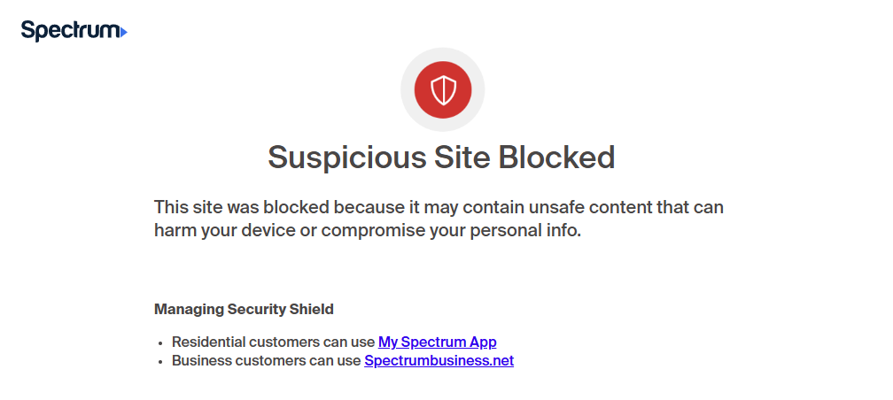

The attached pic "ProgramError" is what I get when trying to check for updates from within LOGic (Help/Check for updates) followed by the pic "LOGic Updater-UnhandledException". The Program Error says it could not establish a secure channel for SSL/TSL, the UnHandled Exception says site blocked because it may contain unsafe content. I posted these pics before but again here. If I run the updater from LOGics program folder I dont get the "ProgramError" but it does throw the "UnhandledException".
LOGic Updater-UnhandledException.png (93kb) downloaded 136 time(s).

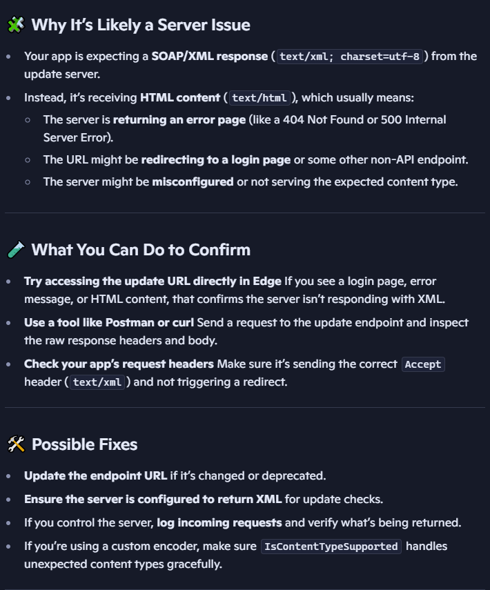

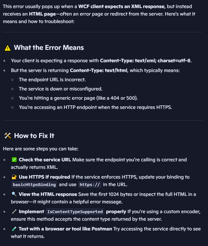

While most of this is over my head, I'm trying to figure out whats going on. After sending the first paragraph of the unhandled exception error text to an AI bot for help, here's what it replied with;
Hope this can help get to the source of the problem.
LOGic Updater-UnhandledException.png (93kb) downloaded 174 time(s).
LOGic Updater-UnhandledException-WhatItMeans.png (150kb) downloaded 152 time(s).
LOGic Updater-UnhandledException-WhatItMeans2.png (156kb) downloaded 153 time(s).

OK, I think I misunderstood. The error isn't when downloading the update, but when trying to start the updater. Is that correct? I will try hooking up an https: link to the server. Stay tuned.

Yes, the error occurs immediately after launching the Updater. I mostly use the standalone Updater program from LOGics folder. If I use the updater from LOGics desktop (under Help) I get a program error first (OLE Dispatch error attached) then I get the unhandled exception error. Side Note: The program error if you click ignore shuts LOGic down. I'm sure the program error will go away if the unhandled exception error can be fixed.

Ok, so I'm getting a suspicious site block from my internet provider Spectrum. Spectrum has been a PITA for years but I havent had issues like this before. I just submitted a form to have the site unblocked, I may not know anything for a couple days.
I dont know why its looking for a secure connection, my security settings are pretty low and I dont see where or how I can change that. Its just strange after all these years this the site is now getting blocked.

Brad, based on what is shown in your pic, you should be able to whitelist the site in your providers app. There's a link there so you can configure it.
