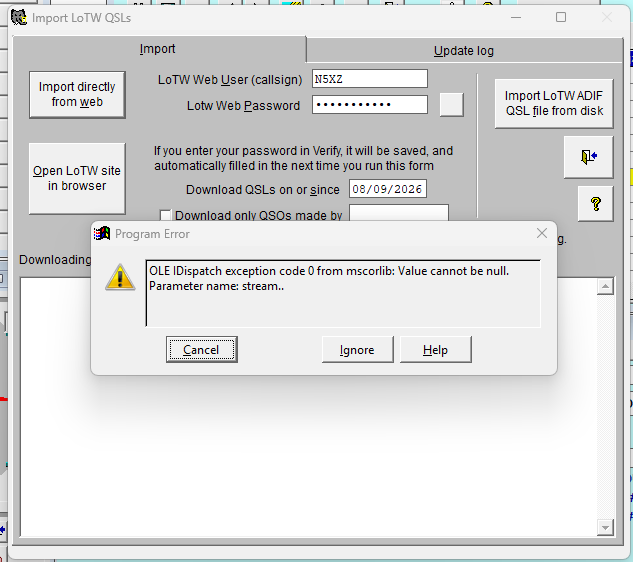

I've been getting this same error code all weekend from LoTW (see attached). Maybe LoTW is having some issues...anyone else having issues this weekend?
But why is it when I hit the CANCEL button that LOGic terminates? This happens with many error messages. When I hit CANCEL, I would expect to just go back to normal and eventually exit out of the function I'm working on. What's going on?
Screenshot 2026-08-30 175141.png (45kb) downloaded 29 time(s).

Hi. That is how FoxPro works. Click cancel, in the runtime exits. What you want to do is Click ignore.
If you want to call or text the next time it does that, you might catch me in the office. If I can reproduce the error, I can handle it better.
N5XZ on 9/3/2026(UTC)
#4 Posted : Thursday, September 10, 2026 9:38:10 AM(UTC)
Someone called with this error. ARRL down, I successfully trapped it. Turns out it is an internal server error (at ARRL). Fixc will be in the next update.
