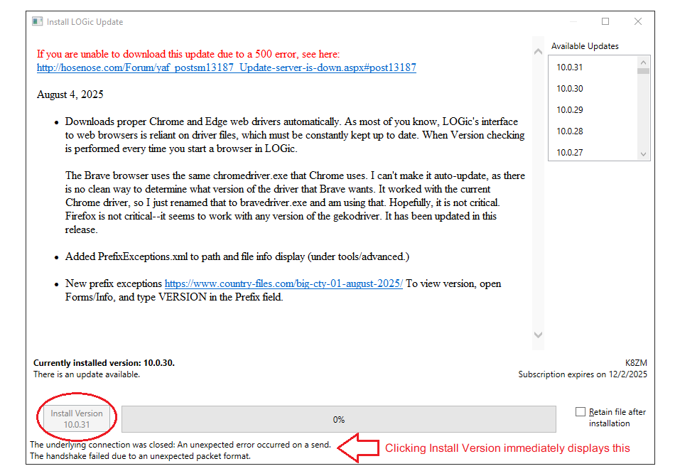

Tried to install v10.00.31 and got error "The underlying connection was closed: An unexpected error occurred on a send. The handshake failed due to an unexpected packet format". Snippet attached of the "Install LOGic Update" window.

Having reverted back to v10.00.30, I found SlimDX Runtime.NET 4.0 x86 (January 2012).msi in LOGics public folder and ran a "Repair". Re-launched LOGic v10.00.30 and all seemed fine....Pheew ! Then re-ran LOGicUpdate_10.0.31.exe previously downloaded from your link but disabled Defender this time just to be sure and all, including SlimDX Runtime installed fine. So am now working with latest update 10.00.31 and so far no screen freezing....WoooHooo!!
This leaves only the installer which still reports the "Unexpected Error on Send" (pic re-posted below)
v10.00.31 Unexpected Error on Send.png (63kb) downloaded 165 time(s).

In the Updater, what exactly is happening when you click the "Install Version 10.0.31" button ?? Can you give me a list of what occurs first, second, etc ??
The instant I click on the "Install Version" button it immediately displays "The underlying connection was closed: An unexpected error occurred on a send. The handshake failed due to an unexpected packet format." This message comes up so fast I can't believe it. Once it shows it, it adds to the desktop the LogicUpdate_10.0.31.exe file even though I didnt check the "Retain the file after installation". Also if I try to close the Updater, it pops up a window saying a file download is in progress even though its not. I'm just trying to dive deeper into whats going on. Thanks for any help !!
v10.00.31 Unexpected Error on Send.png (67kb) downloaded 174 time(s).

The first thing that happens is that it downloads the update using HTTP pretty much like your browser. After the download completes, it runs the update. Then finally, after the installer exits, if RETAIN is not checkmarked, it deletes the download.
So it starts the download. It gets to the point of creating the empty file. The unhandled exception occurs and the program terminates before it can delete the file.

So I reviewed the link and IPV6 and IPV4 protocols and all the test combinations passed from the link they provided. So, what is the server address its trying to connect to ?? Is it at http://hosenose.com or https://hosenose.com ?
I seem to think this may be yet another issue with my ISP, Spectrum, especially since they were blocking the Updater just recently, so I wonder if they missed something when they unblocked it. If all LOGic related server access is to a Hosenose.com server I will send them another unblock request for everything at that domain.

RESOLVED with new WIN 11 PC and CLEAN Install of LOGic !!
