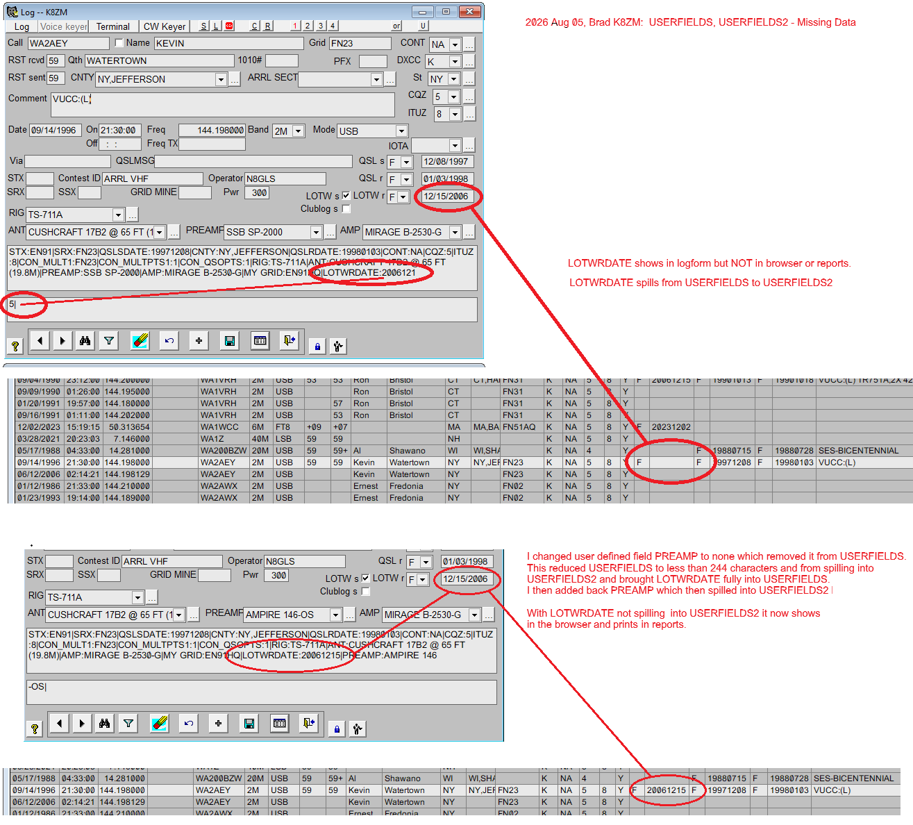

I have been adding several user defined fields and I noticed that USERFIELDS in many records now has only part of the user defined field data, i.e., |LOTWRDATE:20260804| would appear in USERFIELDS as |LOTWRDATE:20260 so its being cuttoff. I see where when this occurs the date in the logform for LOTWRDATE is blank. I know I have exceeded the 244 character limit for USERFIELDS but thought USERFIELDS(2) would pick up the entire pipe not just extend the characters from USERFIELDS. How can I fix this ??
Update: So I filtered the log to show only USERFIELDS > 240 characters and got 13 QSO records. I could delete a user defined field or two but curious how USERFIELDS and USERFIELDS2 actually work. If you add more userdefined fields to a record where the 244 character limit gets exceeded by less than the # of characters in the pipe, does the entire pipe get moved to USERFIELDS2 or does the userdefined field just get split between USERFIELDS and USERFIELDS2 ?? Say I add userdefined field JUNK and it can contain 10 characters ( JUNK:0123456789 ). If that QSO record has 240 characters in USERFIELDS will JUNK get split between both USERFIELDS ( |JUNK goes into USERFIELDS and :0123456789| goes into USERFIELDS2 ) or does the entire pipe |JUNK:0123456789| get put to only USERFIELDS2 ??.

Ok, USERFIELDS spills into USERFIELDS2 when USERFIELDS character count exceeds 244 characters. However, when USERFIELDS spills into USERFIELDS2 the spilled field does not show up in the browser or in reports. I tested this by clearing some user defined fields and the browser and reports show fine, if I add back user defined fields whatever is spilled into USERFIELDS2 does not show in the browser and reports.
Different issue: I found it odd when filtering the log for LEN(ALLTRIM(USERFIELDS))>240, of 13 QSO records only 6 of them spilled into USERFIELDS2, the other 7 records showed nothing spilling into USERFIELDS2.

I havent tried every report but the awards report was the one I was looking at. I attached a pic showing the logform with userfields and userfields2 and you can see if a field spills into userfields2 it doesnt show up in the browser window.
