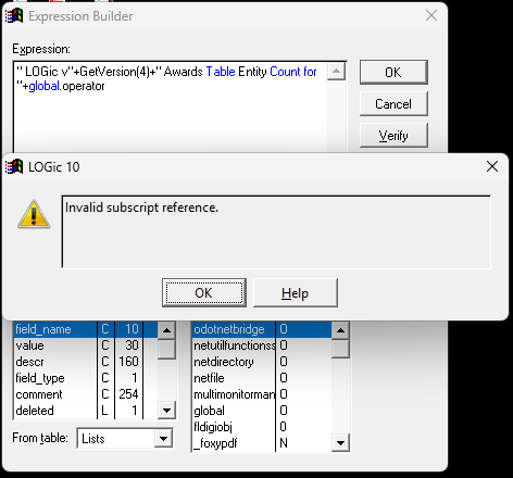

Tried using this but get "can't find GetVersion(4)". Does it need a table reference like Global or Report ?? I found Version in the Reports table but it only returns the 1st number of the last 2 numbers in the version, i.e., if version was 10.0.35, its returning 3 but not 5. It looks like its only a 2-character field but not sure why it would'nt return 35. Don't know if or where this Version variable is used but since it partially works is it possible to make it 8 characters, i.e. 10.00.35?? GetVersion(4) I guess is supposed to return the last 4 characters of the version number??

Not sure what is going on. Same old story, it works here. You don't have to do anything to set up for it. Just add the expression to the report.
First check Help/About and make sure you really have version 10.0.35.
Then go to tools/advanced/database commands. Type
? getversion(4)
followed by {Enter}. It should display 10.0.35.
I admit I never actually tested it in the report writer. But it works. See the attached example. I added getversion(4) to the northwest corner of the page. Uncompress into the REPORT folder inside where LOGic is installed.
Let me know!

#5 Posted : Friday, July 31, 2026 9:36:31 PM(UTC)
Posts: 624
Was thanked: 239 time(s) in 215 post(s)
It "always" works over there !!! BigGrin
So, why I "thought" it didnt work is because I added it to a report, then in the expression builder clicked on "Verify" and it reported "Invalid subscript reference". So just assumed it would'nt work.....BUT....as usual, I went back and added it anyways, ran the report and like MAGIC....there it is !

#6 Posted : Monday, August 3, 2026 9:33:30 AM(UTC)
Not sure why Verify doesn't see it. Will play around when I get a chance.
