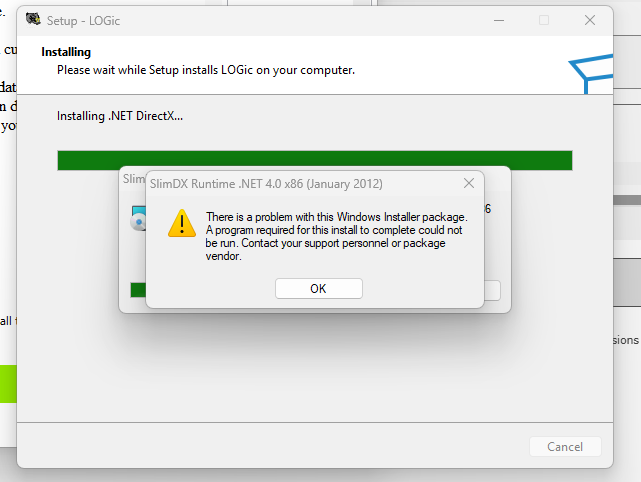

#7 Posted : Wednesday, July 15, 2026 1:04:04 PM(UTC)
Posts: 474
Thanks: 41 times
Was thanked: 81 time(s) in 76 post(s)
Yeah, did the same thing and working here now, too. However, I've been getting the attached error message for many updates, I have just hit OK and the installations continued. See attached.
Screenshot 2026-07-15 125954.png (41kb) downloaded 7 time(s).
WN4AZY on 7/15/2026(UTC)
#8 Posted : Wednesday, July 15, 2026 2:40:51 PM(UTC)
Posts: 3,222
Thanks: 1113 times
Was thanked: 542 time(s) in 452 post(s)
OK, I could not reproduce any problem importing eQSL.
It looks like the update didn't install properly.
I don't think the error installing SlimDX is actually a problem. It is the same version we have used for years, and would not affect eQSL. It is used for playing sound. Did the installation continue? I have seen this error before. Don't know what's causing it.
Does Help/About show 10.0.34?
Are you still getting runtime errors?
#9 Posted : Thursday, July 16, 2026 1:00:53 AM(UTC)
Posts: 474
Thanks: 41 times
After reinstalling .34 downloading eQSL is working again, no problem.
I just ignore the error message when installing the new versions.
