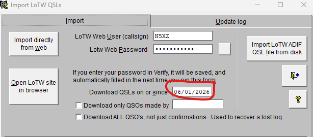

What I have determined is that somehow LOGic loses the date: "Download QSLs on or since ... ". After adding a date to this field, the download works.
Dennis, do you know why LOGic would lose this date information???

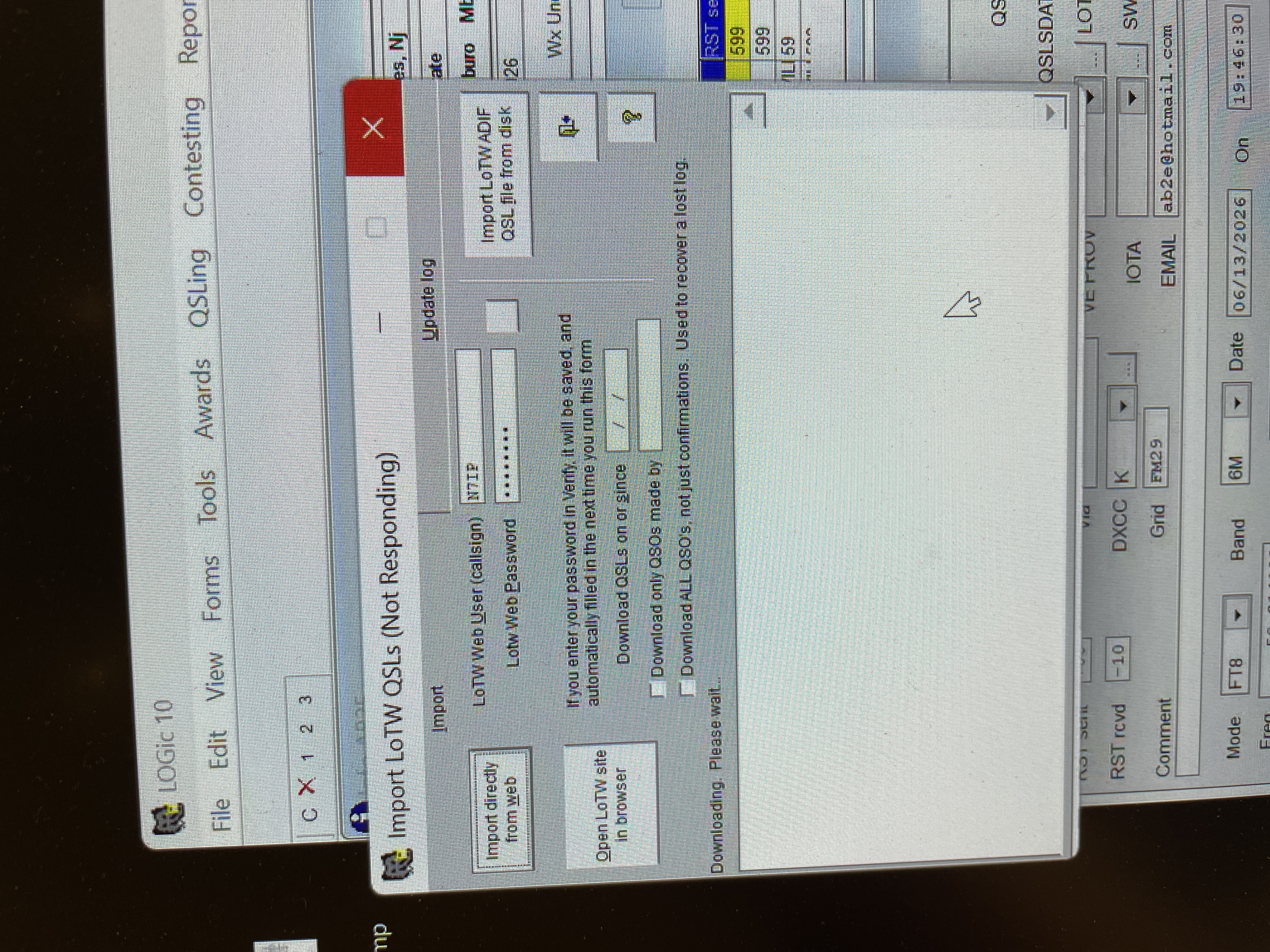

After reloading Logic, I now hve this problem too. After awhile, I see "insuffient stack space"
If I fill in the "date after" fied, I get an OLE error.
Bob, N7IP

Dennis, update 33 did not solve this problem. See the screen shot attached.
Bob

Bob, you're gonna have to enter in a date for "Download QSLs on or since". That's what mine kept losing, too. You'll have to go back to see the last download from LoTW and enter that date. PITA

Sorry guys. Not seeing a problem here.
Go ahead and enter the date manually the first time. Or leave it blank to download everything. Proceed with the download. When the download completes, go back to the main page. Today's date should be filled in there. It should remember that date even if you exit LOGic and return.
I also tried manually entering a date. 1/1/26. I didn't actually do any download. But I exited the form, exited LOGic, and came back. 1/1/26 was still there. I couldn't make this fail. I entered 6/7/26, did not tab out of the field, and closed LOGic. My date stuck.
In other words, here are the rules LOGic follows:
1. Any date, including a blank date, will be remembered when you exit the form.
2. The date will be updated to today's date after completing a download.
If that isn't happening, I can log in and take a look.
If you want to proceed to troubleshoot on your own:
The date is stored in your LOGDATA folder in stationinfo.ini. Look for APP_LOTW_LASTQSL under the [LoTW] section header.
Try editing stationinfo.ini by hand. Use Notepad or any text editor. Make the line under [LoTW] look like this:
APP_LoTW_LASTQSL=20260607
If the line is already there, change the date. Save your changes. If you get an error when trying to save, you have a permissions problem. Manually saving MAY fix the problem.
When you go into LOGic, 6/7/26 or whatever date you put in stationinfo.ini should appear.
