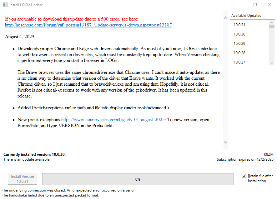

Tried to install v10.00.31 and got error "The underlying connection was closed: An unexpected error occurred on a send. The handshake failed due to an unexpected packet format". Snippet attached of the "Install LOGic Update" window.
Thought these types of errors only occurred on Mondays (hihi) !!
v10.00.31 Unexpected Error on Send.png (63kb) downloaded 8 time(s).

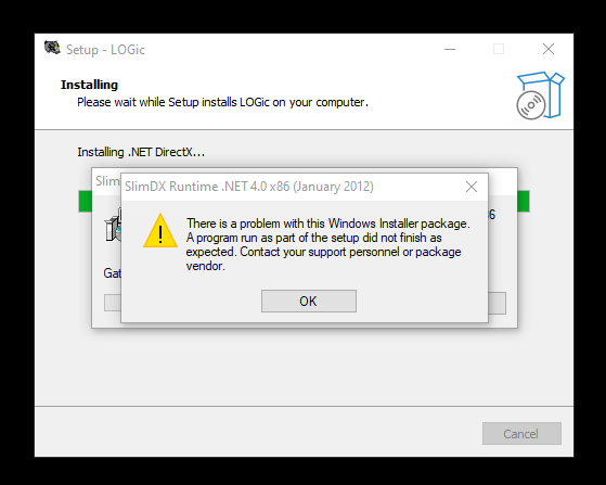

Tried the direct link and windows defender stopped it from downloading. I over-rode it and let it install, when the install got to SlimDX Runtime it threw an alert that a program run as part of the setup didnt finish as expected (see attached).
LOGic did launch but I didnt get the usual installing the prefix table listing in blue text at the top left of LOGics desktop, just the sentence "installing the prefix table" for about a second then LOGic continued launching. I'll fool around a little in this version but dont want to do too much and will revert back to 10.00.30.
Never had these kind of errors before....
PS: v10.00.31 is freezing up, so tried to revert back to v10.00.30 using LOGics installer and got the same installer error as v10.00.31. I keep copies of updates so tried to install LogicUpdate_v10.00.30 and got the same SlimDX Runtime issue. LOGic launched but also freezing up so am stuck in the water at this point.
PSS: Tried to re-install LogicUpdate_10.00.30 again and still got the SlimDX Runtime issue. LOGic seemed to install and launch and not seeing any freezing or other issues yet. So except for the SlimDX Runtime issue it seems ok for the moment. Can you link me to the SlimDX Runtime executable and maybe I can install or replace this one and resolve that issue. The installer still shows the same "Unexpected Error on Send" even when trying to install v10.00.30.

Having reverted back to v10.00.30, I found SlimDX Runtime.NET 4.0 x86 (January 2012).msi in LOGics public folder and ran a "Repair". Re-launched LOGic v10.00.30 and all seemed fine....Pheew ! Then re-ran LOGicUpdate_10.0.31.exe previously downloaded from your link but disabled Defender this time just to be sure and all, including SlimDX Runtime installed fine. So am now working with latest update 10.00.31 and so far no screen freezing....WoooHooo!!
This leaves only the installer which still reports the "Unexpected Error on Send" (pic re-posted below)
v10.00.31 Unexpected Error on Send.png (63kb) downloaded 5 time(s).

If you disable Windows Defender, wil the LOGic updater then work?
Even with defender off I get the same "Unexpected Error on Send". I'm gonna try to update the updater client and see if that fixes anything, I'll PS this with the result.
Hi Mauro, hope you are well !!
PS: Updated the Updater and get the same "Unexpected Error on Send".
