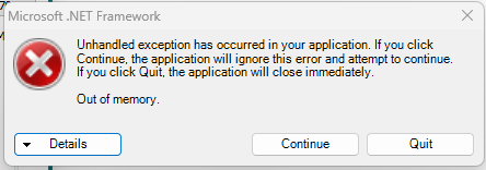

OK, tonight I tried to import eQsl records, after importing LotW records. I got the attached error message, afterwhich LOGic terminated without additional input. After reloading LOGic, everything worked just fine.

FB on your explanation of the WSJT-X problem.
Thanks for the error message.
Is the error reproducable?
Another thought. We used to have a lot of problems with non-FTDI RS232=>USB drivers. Also, the USB=>RS232 drivers that come with rigs did not seem to be a problem. Anything else could cause instability. And, hardware can go bad and cause wierdness. My USB web cam caused crashes, though with Windows, and not LOGic particularly.
Please try temporarily disabling any radio or rotor interfaces in LOGic, and see if stability returns.

Here are today's error messages. All happened while running WSJT-X. Clicking IGNORE allowed software to continue. No LOGic crashes or terminations today.
Last email you mentioned non-FTDI RS232=>USB drivers. I have confirmed that I am running the correct drivers and there is no external RS232=>USB cable (built into K4D radio). These are the exact same error messages I got when using a K3 and a different computer. Seems like that might rule out the radio and computer so some extent. Are there any old files that I should delete that could cause this issue?
